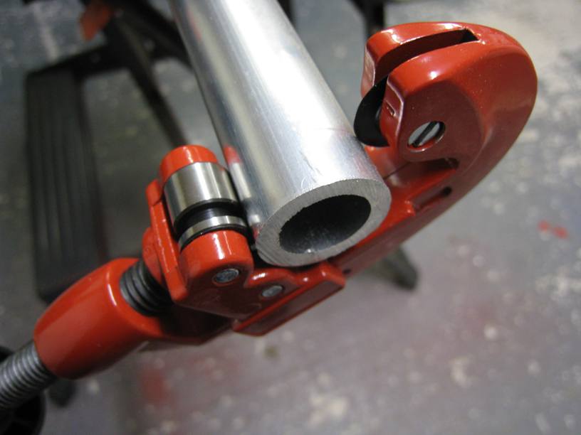

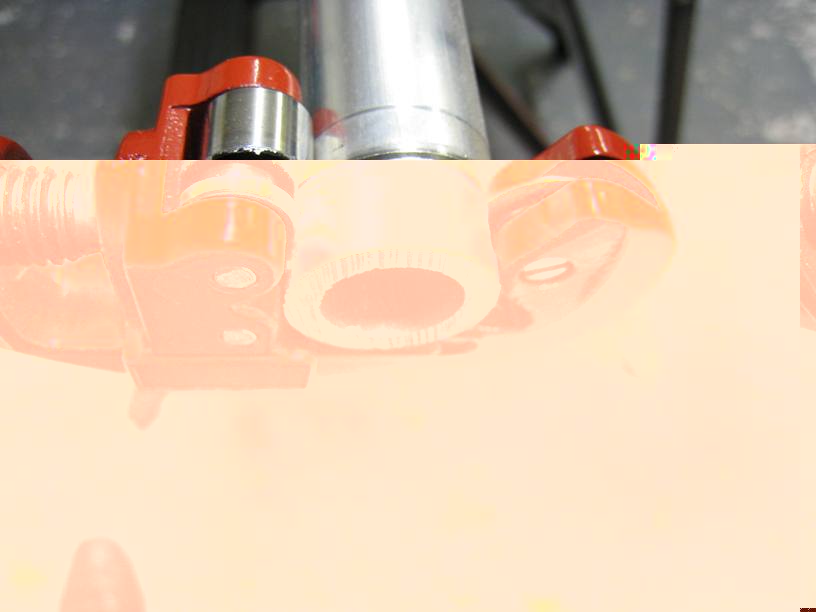

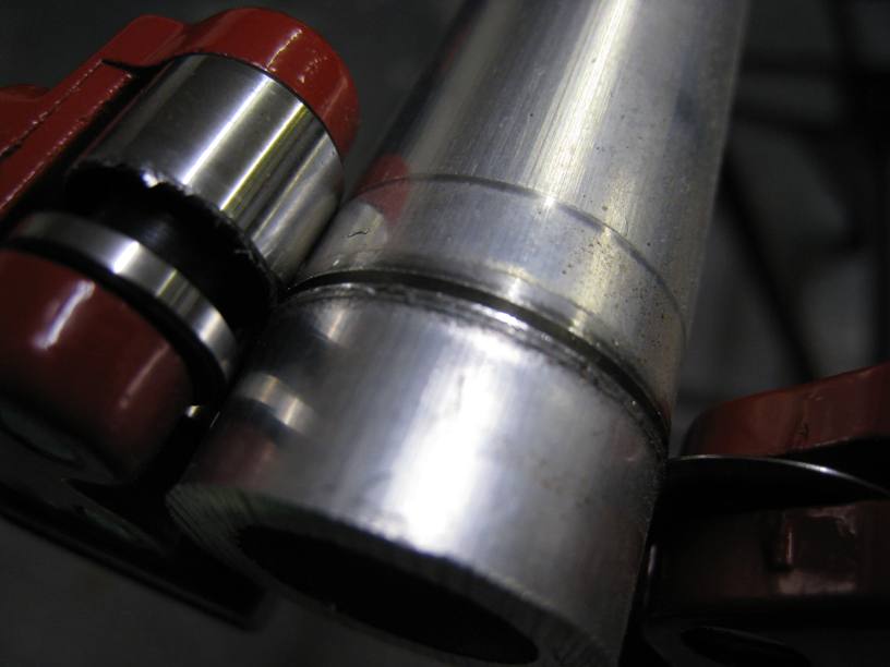

I’ve used a heavy duty pipe cutter I bought from Machine mart (Product CHT242 current price £8.39). When cutting the material this tool works extremely accurately and has a de-burring tool which comes in very handy.
It took no more than a minute to work through the metal and cut the material leaving a very straight edge. Some splaying does occur and burring but this is easily dealt with as you will later see. Here are some pictures 1-3 below are of the cutting stage.

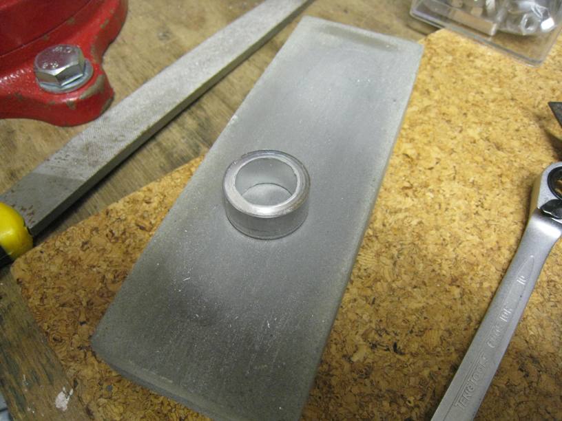

I then cleaned up the inner edges using the de-burring tool on the pipe cutter and also cleaned up and flattened the faces on a sanding stone as the pipe cutter puts a slight chamfer on the face, steps as shown pictures 4-5.

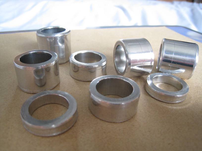

Just thought I'd add this to show some finished examples made using the above method.

Hi Tim
very neat indeed and much better looking ( and lighter ) than the ones i made in desperation from Stainless steel tube ! I had to clean them up with wet and dry and elbow grease !!!
