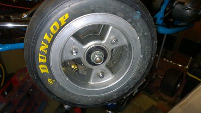

Re: Blow Hustler
Hi Steve
What type of rims are you using? If you are using the split rims fitted you can probably get some from Dave Howarth.
What is that peculiar arrangement on the front hubs? Have spacers been fitted between the drums and the hubs? I think you have hubs originally for 6" diameter wheels. With a 6" wheel the inset of the wheel fits over the brake drum so hence the spacer. Look at the front hub on mine which has 6" wheels.
If you want to return it to original Azusa wheel are available from the US and new tyres are available from Hoosier (they are for the superkart series). 2nd hand slick & wet Dunlops can be bought for next to nothing from Superkart owners.
Tim
Tim

Re: Blow Hustler
Hi Again Steve.
The Hustler was fitted with both 5" and 6" wheels as standard. 5" had a 4" drum and 6" a 5" drum. three bolts went through drum and both halves of the wheels. Drum was inset into wheel. See the photos attached. If your drum is a 5" the spacer is so 5" wheels could be fitted as the drum would be too big to inset into the wheels.
Wheels in picture are Azusa wheel fitted as original and still available.
Both sizes of wheel fit onto the shouldered 1" rear axle.
