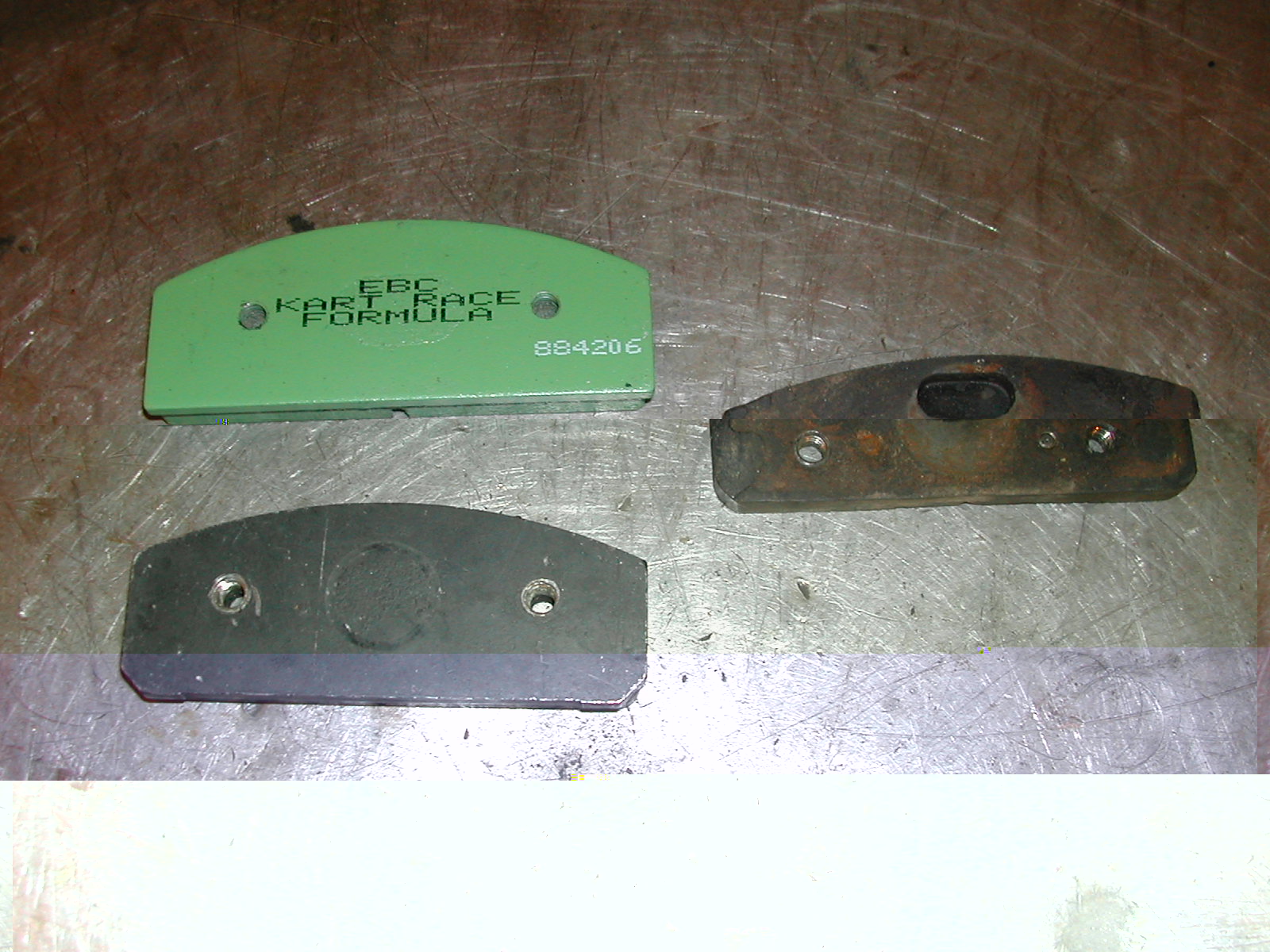

I was told about the mechanical disc brake that Zip made a short while ago and they used a quite similar pad. The good news is that these pads are still in stock with selected kart suppliers but the bad news is that they are not a straight swap.
Some fettling is needed. Here are the pads, they are off a Zip cadet mechanical disc brake.
The hole centres are the same but the pads are bigger and thicker.

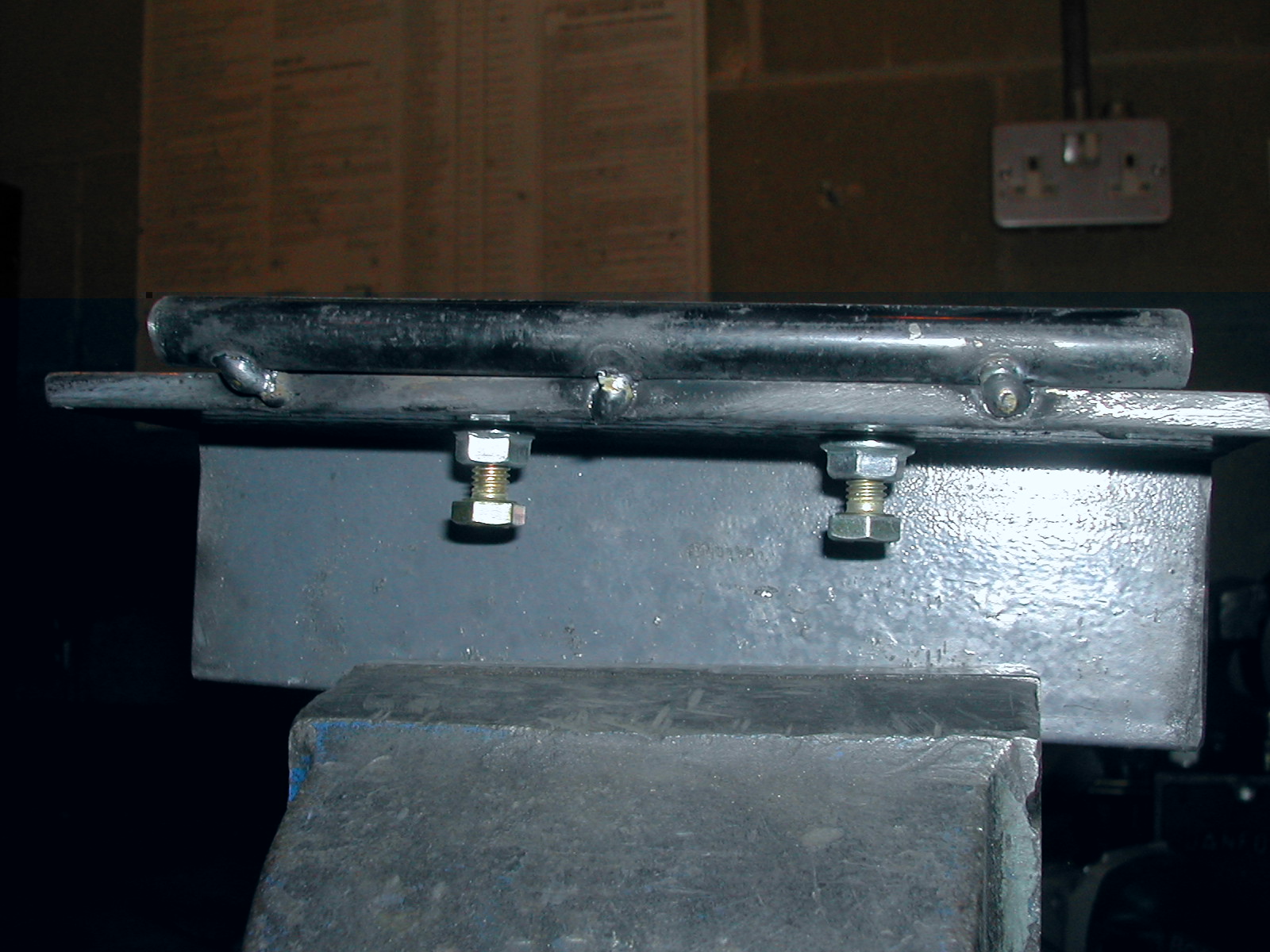

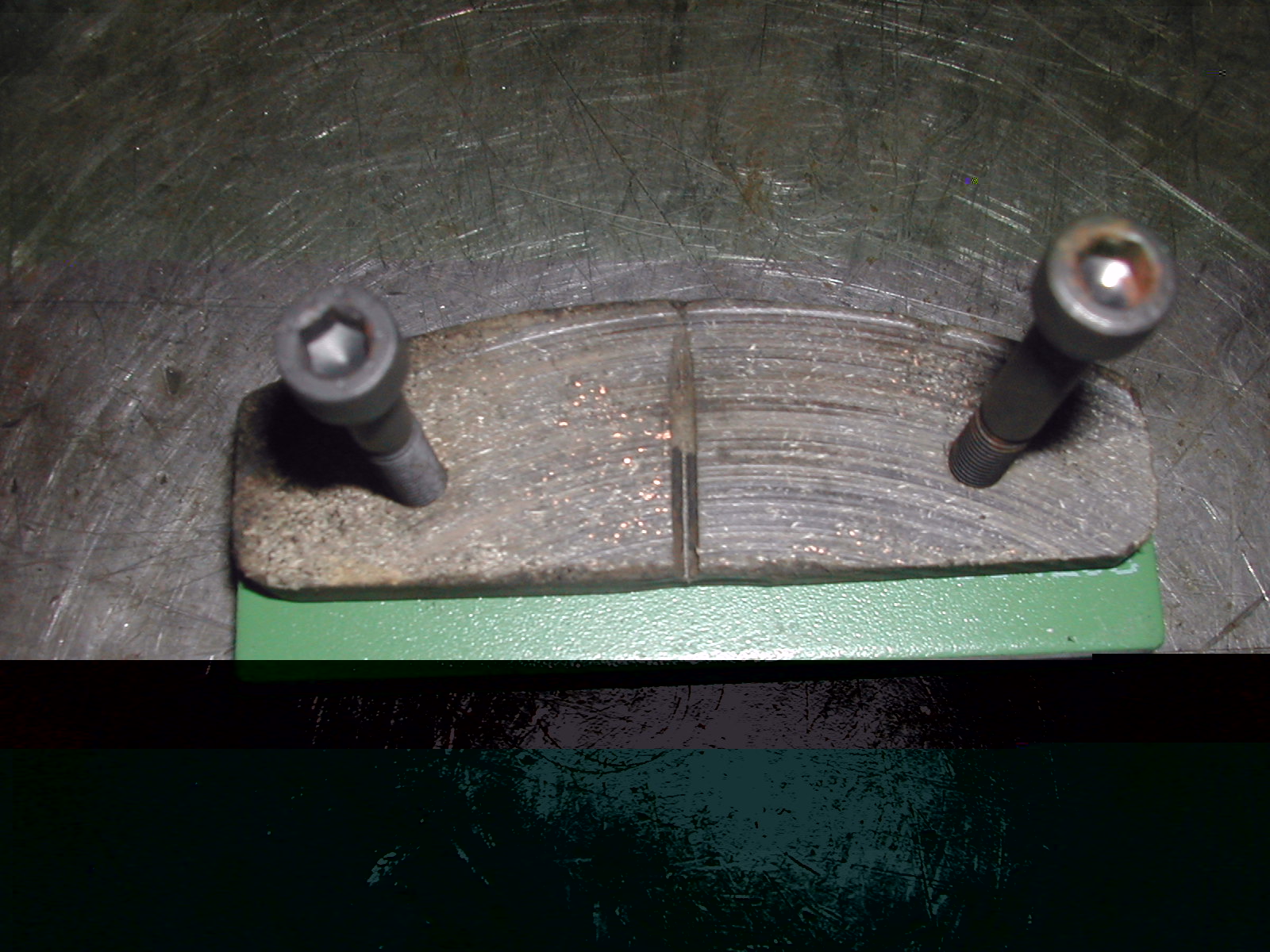

I then bolted the the original pad to the new ones and scribed round them. Then cut the new pads to shape with a hacksaw and grinder.
Then i just needed to shave them down to the right thickness. As my discs are quite thin i needed to get the thickness down to 10mm from 12mm. For this i made a quick jig that the pads bolt down to and two 10mm guides so i can get the pads nice and even.
I roughed them down with an angle grinder and finished them off with a file.
The dust is quite harmful so wear goggles and a dust mask.
Quickly deburr them and you have a new set of pads.
The new pads retail at £13 a pair from EBC and £35+vat a pair from spellfame. Bit of a no brainer that one.
EBC ref number FA 527S for the green pads and FA 527 for the red. Have no idea which is the better compound.
