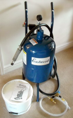

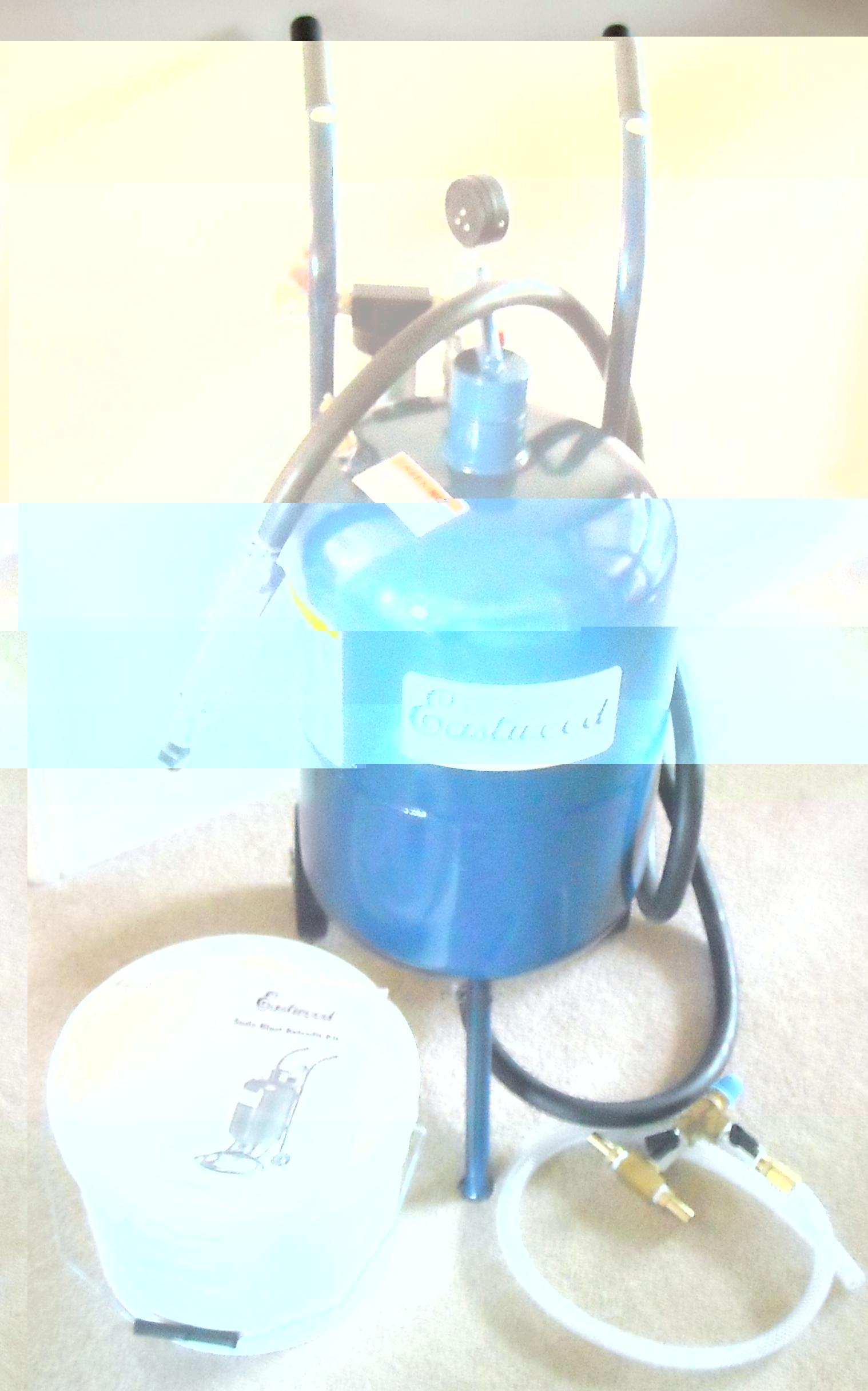

JIM COULTHARD
Re: Soda Blasting engine parts
EASTWOOD SODA BLASTER WITH DEADMAN VALVE
I WAS THAT IMPRESSED WITH THE VIDEO I WENT OUT AND BOUGHT ONE.
( Eastwood's Soda Blaster on My Classic Car ) on YOU TUBE
The environmentally friendly way to remove paint, graffiti, antifouling etc. without damage.
Can be used on aluminium car panels, fibreglass, timber, brickwork etc.
Requires minimum of 8cfm at 80psi.
