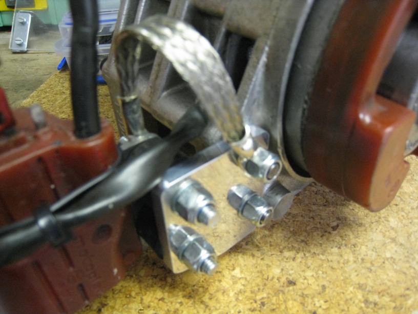

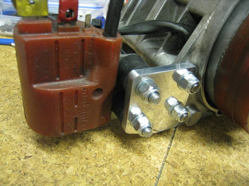

I guess we all know that Motoplat Coils may sometimes suffer damage through the high revs of the engine the mounts can crack or electronic components can fail.
What I’ve done with mine is to try and prevent the damage through mounting the coil on rubber bobbins. I wanted to keep to engine in as original state as possible hence not make anything to permanently change it so for show purposes it can be put back to its original coil fixing points.
I’ve also tried to make sure that I provided the earth strap with good connection points. The pictures below is what I’ve done for a Hewland understanding that it may have to be designed differently for other makes of engine. This modification was made out of 50mm high X 6mm thick aluminium bar and was cut to form a bracket 45mm long.
