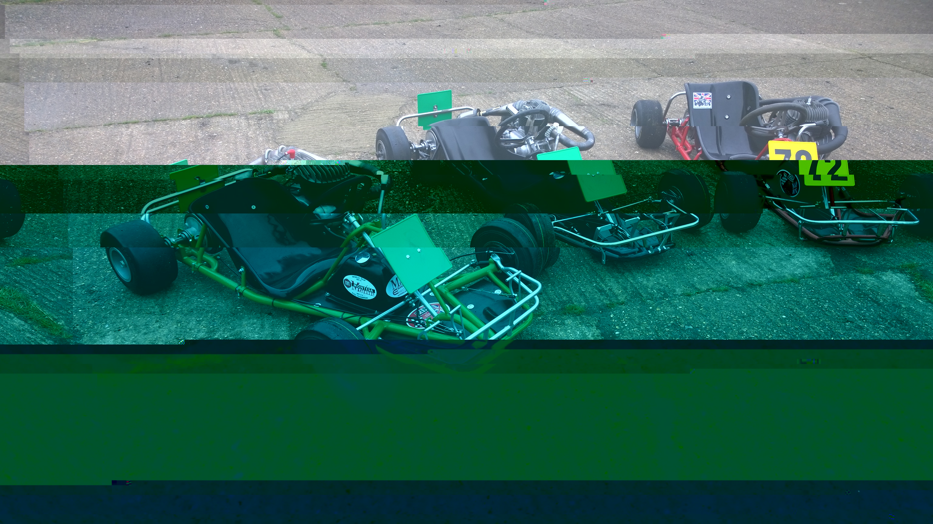

Hi David - This photo shows two Zip Silverstone's (on right). The '68' model and the '72' model. The 68 had 410/350-5 tyres on Blow split rims. The 72 has 10.5x4.5-6 (ignore the 6 diameter) on Zip split rims. Both are correct sizes for the period. I think your Mk V Silverstone has the correct rims and your kart should have the smaller 410/350 tyre fitted. The tyres you have are for the Historic period according to RaceRetro regs. Your Silverstone is from the Vintage period.
Res are here - http://www.retroracer-hks.com/downloads ... 20Regs.pdf
Tyres for vintage are on page 4.

Hi Tim, skinny fronts it is then!!
Many thanks for your time and effort,
Best regards
Dave
